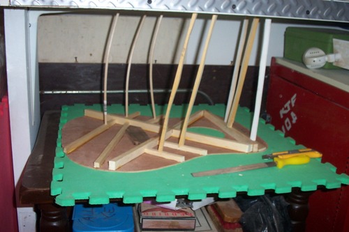

D.L., This is what i use, it's got a perfectly flat side and all cushiony and a rough surface on the other side so it doesn't slip off the workbench, easy to store if they're in your way and easy to clean with the shop vac or a damp cloth.
